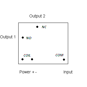

#11 ShadowFox
Posted 17 October 2005 - 02:05 PM
___________
| o -NC |
| o -NO |
| 'coil ' com|
| o o o|
___________|
That's all that I know... help me out with that?
well darn it... let me make you a diagram then stupid forum not allowing multiple spaces :P
okay here is a paint diagram of what I know... pleas try to explain this to me via diagram... I like visual aid :(
Attached File  spdt.bmp   88.8K   133 downloads
Edited by ShadowFox, 17 October 2005 - 02:05 PM.
#12 ShadowFox
Posted 18 October 2005 - 02:06 PM
Just you know open that one, copy it, paste another one besides it... use different colors for wires... I can figure it out from there :P
Please.... Pretty Please

#13 Visentinel
Visentinel
  • 998 posts
  • Location:NSW Australia
Posted 19 October 2005 - 04:54 AM
2kb gif :)

#14 Neon
Posted 19 October 2005 - 10:07 AM
What would we do without Visentinel...
Did it work shadow? :)
#15 ShadowFox
Posted 20 October 2005 - 03:13 AM
don't know I was busy today I will try it out tomorrow.
