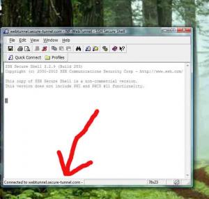

If you are on Vista, you would have to download a copy of SSH and a grab a reg file from here. Install SSH but don't open it and double-click the reg file you downloaded. Then, start up SSH and enter your ST username and password. If you connect properly, you shall see this:
Attached Image: st.jpg

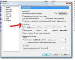

Once connected via SSH, start up your torrent program (I use uTorrent) and find your connection preferences so you can choose to "connect via proxy." Should look similar to this:
Attached Image: st2.jpg
The proxy name is webtunnel.secure-tunnel.com and you just use your regular ST username and pwd. The port has to be 8080 though.

No worries Nvy. :cheers: Couple things I forgot to mention-----> you will have to make sure that port 8080 is forwarded on your router/firewall like similar apps.
